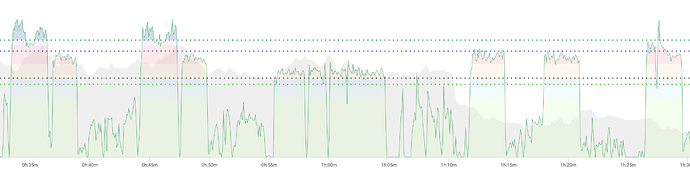

Here are a few screen shots of my workouts outdoors- you can see where I had to stop during an interval. Sometimes I pause the lap timer, sometimes I don’t, depending on the interval:
